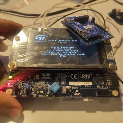

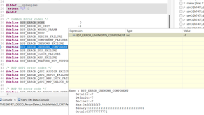

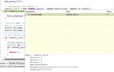

I'm working on artificial intelligence on STM32H747. I started my work with projects on FP-AI-VISION. First, I solved the display problem caused by NT35510 and tried the project again. When I tried it, I got the look in the first photo. At first I couldn't understand what was happening because I thought the problem would be solved when I fixed the screen. Afterwards, I debugged the code and saw that the BSP_CAMERA_INIT function branched to Error Handler. I looked into what error message I was getting and saw that I was getting the BSP_ERROW_UNKNOWN_COMPONENT error. How can I solve this problem? I just unpacked the camera so I hardly find the risk of the camera getting a hardware fault. Do I need any extra action to operate the camera?

It didn't work only because we encountered a hardware problem with the camera. We replaced the camera and now we can continue our work properly. Thanks for all your answers.

The BSP_ERROW_UNKNOWN_COMPONENT can happen if the camera is not detected. It might be due either to a wrong connection or a malfunction of the camera board.
Be sure to plug and unplug the camera board while the board is not powered. A short-circuit can happen otherwise.
You can check the LED status on the camera board too.
