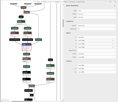

Hello @uveuvenouve,
The issue here is that bidirectional LSTM are not supported in ST Edge AI
You can see below that your node_339 is the bidirectional LSTM:
You can find the list of supported ONNX operator in the ONNX toolboox page in the CubeAI Documentation:
https://wiki.st.com/stm32mcu/wiki/AI:X-CUBE-AI_documentation#X-CUBE-AI_embedded_documentation_access

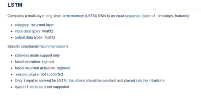

Concerning the LSTM:
