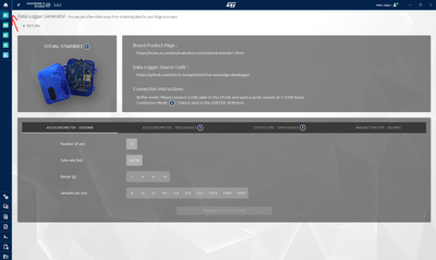

In NanoEdge we provide the datalogger generator:
And the source code, that you can probably edit more easily:

Hello @Julian E. ,
Thank you for your explanation. I actually already solved the issue — it turned out to be related to the firmware. At first, I had downloaded the generic datalogging firmware, but for the emulator to work correctly I needed to flash the .bin file generated by Nano Edge AI Studio for the specific sensor I’m working with. Once I did that, the emulator was able to recognize the data shape and run without errors.
Thanks again for pointing me in the right direction!
