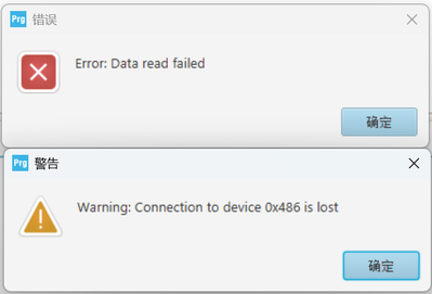

After connected, I choose the "ai_fsbl.hex" file, and clicked "start programming".Then the connection is disabled, with 2 messages saying "connections to device 0x486 is lost" and "failed to download files".

16:51:32 : Warning: Connection to device 0x486 is lost
16:51:32 : Disconnected from device.
 After the disconnection, I can't connect the board to the CubeProgrammer again until I unplug the wire connecting the board with my laptop and then plug it back. Same error messages show every time when I try to connect the board again.

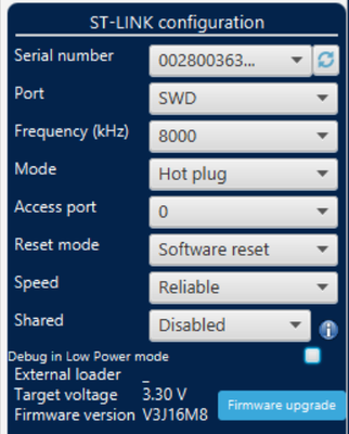

1. The ST-LINK configuration is shown below:
I've tried changing some of the configuration like "Frequency", "Mode", "Reset mode", but it doesn't work, the same messages still show.

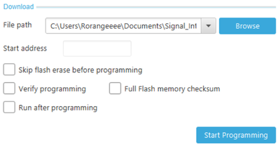

2. The programming configurations are shown below:
I've also tried several different settings, but it still didn't work.

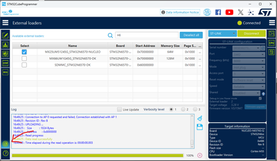

I found the point. I should select the External Loader.
Here's the solution:
Click the "EL" button left-bottom, and search the "STM32N657", select the one with NUCLEO(according to board maybe), and repower and reconnect it. Then the file should be downloaded successfully (at least mine is downloaded now).

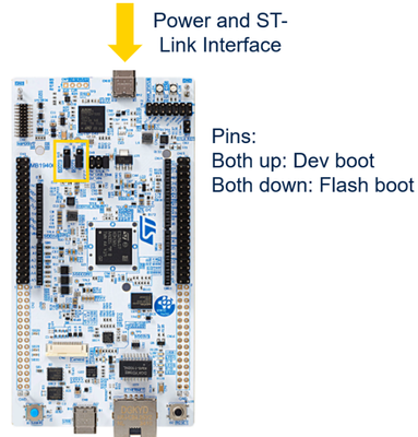

Did you put the board in dev mod:
In this image, the board is in boot from Flash.
To load the .hex files, first put both pin up, unplug and re plug the board, open CubeProgrammer and try to download the firmwares.
Then put the pins back to Flash boot, reset the board again to launch the application.
You can also try to select the External loader in CubeProgrammer:

Thank you for replying! But I've tried different boot modes and it didn't work. When the pins are both down, my laptop can't even recognize my board, saying"no STM32 target found"or things like that(I don't remember the exactly text :( ). When the boot1 is up, the situation is like what I said in the post.
By the way I've also tried using a C-to-C cable, but the problem is still not solved. The cable supports PD and thunderbolt so I think it's not a cable-caused issue...
