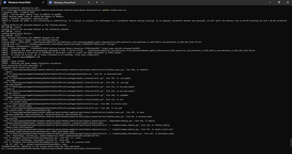

first of all . thanks for the guide you provided . it really helped me doing some progress. Now , after giving the model path and switching the mode to deployment in the .yaml file in src ,i had some other issues ( 3 type of errors i think ) : first of all i had 'login faield' problem' when he asked for my ST account credentials even though i'am 100% they are correct . the second type of errors are related to the hydra   files and third type of errors are related to some files . honestly im really lost in these errors so can u provide me some help , guide, or even some explanations Screenshot 2024-07-03 161018.png
It might be a problem with proxy. Are you running the scripts behind some proxy server? If so, we do provide the guide on how to use STM32ai dev-cloud in settings where you are running behind the proxy servers Wiki article. There are also some guidelines on how to install the local version on your machine (if the online version is not working due to proxy or some firewall).
Furthermore, to avoiding any misalignments due to some file paths or typo issues, may be try to use the deployment_config.yaml file in the "object_detection/src/config_file_examples/".
You can call this python scripts with this file simply from src directory by issuing following command:
python stm32ai_main.py --config-path ./config_file_examples/ --config-name deployment_config.yaml
Edit the deployment_config.yaml file  to point to correct paths of your CubeIDE.exe, stm32ai.exe file and that is all that you need to change.
Once you can reproduce these basic steps, then you can experiment more, for example you can edit the model path to use a different model.
If this does not solve the issue, share the configuration file and model file for us to be able to reproduce the issue.
