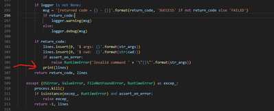

Hello @cosard ,
in Your_Model_Zoo_Folder/common/stm32ai_local/utils.py can you add "print(lines)" at line 306 like so:
Can you please run the script again and send me the message complete log.
Have a good day,
Julian
Hello @Julian E.
I have updated the utils.py script as you told and here is the output after I run:
python stm32ai_main.py --config-path ./config_file_examples/ --config-name deployment_n6_ssd_mobilenet_v2_fpnlite_config.yaml

['$ cwd:  ../../application_code/object_detection/STM32N6/STM32CubeIDE', '$ args: NOT FOUND -c port=swd mode=HOTPLUG -hardRst -w Debug/STM32N6_GettingStarted_ObjectDetection_signed.bin 0x70100000', '/bin/sh: NOT: command not found']
