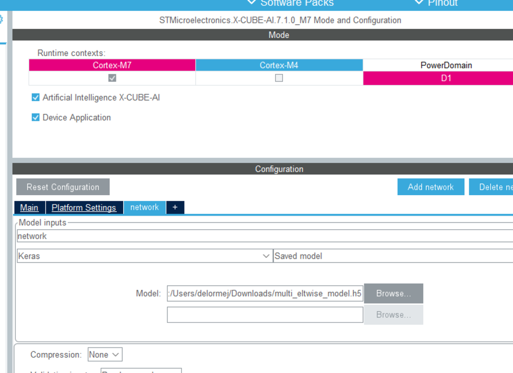

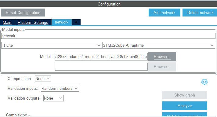

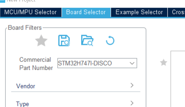

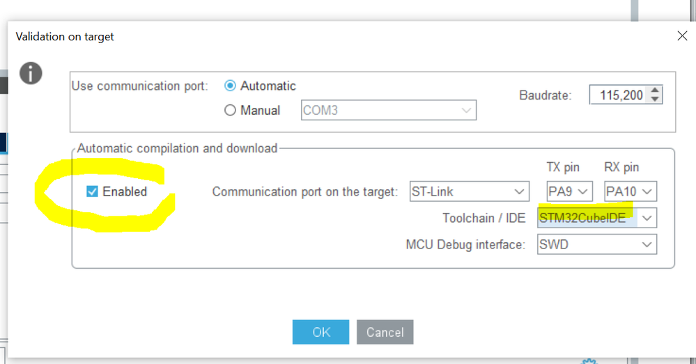

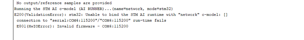

Thank you for your attention. At first I used "validation on target" with my STm32H747-DISCO with the example FP-AI-VISION1_V3.1.0 (because with that I can determine that the problem isn't from the code) and after that I wanted to do it with a F429I-DISCO and a code of my design. And "validate on target" didn't work for the F4 and the H7, I have the same problem as this guy, but the answer didn't fix the problem.
I will show you my method, I'm surely doing it wrong. First I select the card on the select board menu. Then :0693W00000NscX8QAJ.png0693W00000NscOkQAJ.png
0693W00000NscQ2QAJ.pngFinally I resolve cloc issues, generate the code (without changing the minimum heap and stack size), build the CM7 project, plug my board via St-Link, run the code and "validate on target" (on COM-3 and 4). I have always the same error :0693W00000NscY6QAJ.pngThank for your informations, I will look into "How to run locally a c-model" article. It will help me a lot.
I thank you again for your time,

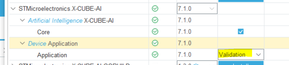

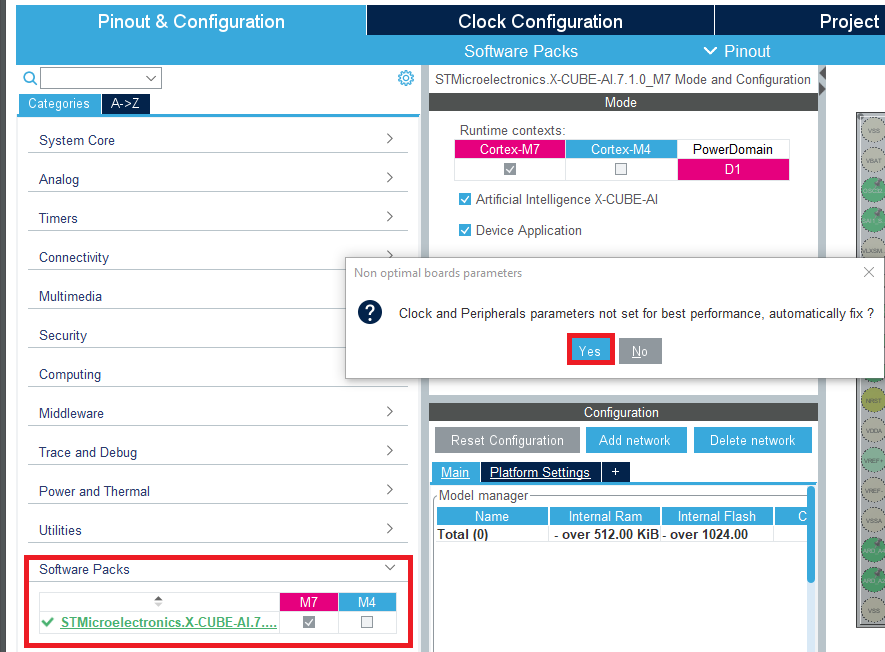

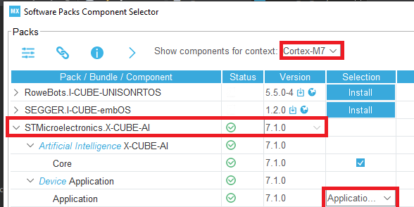

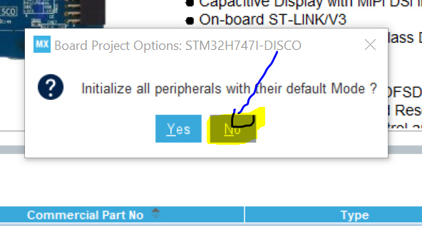

I don't see the real issue in your method. I have applied the following sequence w/o issue.
0 - I have created a new project from scratch with a basic model: CubeMX 6.4.0 + X-CUBE-AI 7.1 + STM32H747I-DISCO
1 - It is preferable to not initialize all peripherals with the default mode.
0693W00000NsdONQAZ.png2 - Select the built-in validation application (Cortex-M7)

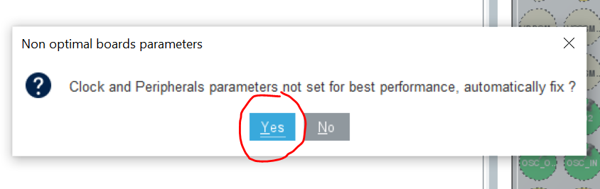

3 - Click "YES" to atomatically set the max MCU clock
4 - Import a model

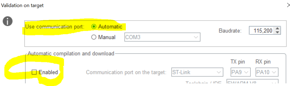

5 - Perform "automatic" validation on target. I have selected STM32CubeIDE here.

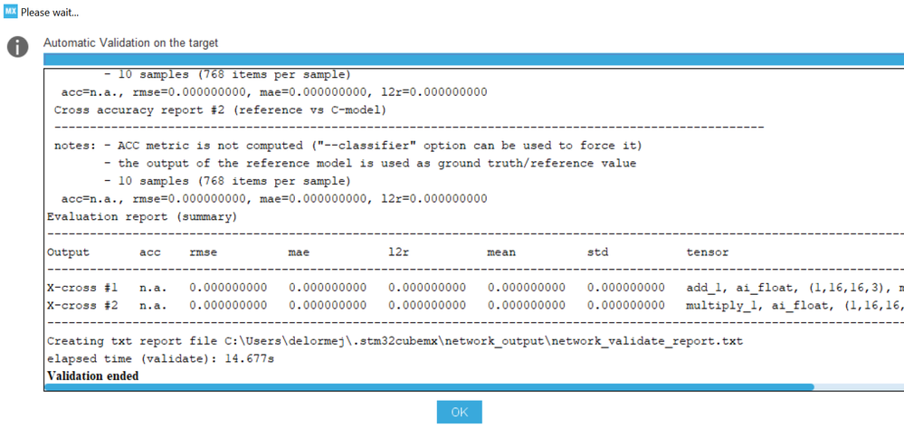

After a build and flash of the two firmwares (M7 & M4), we have:
0693W00000NsdmJQAR.pngAt this step, the board is normally flashed and can be directly used to perform a new validation on target w/o re-generation of the projects with for example the user-data.
STM32 IDE project can be also generated (for debug purpose or for example to increase the heap/stack) for your prefered STM32 IDE.
You open the project with your prefered STM32 IDE, build and flash the board.
After this step, you can perform a new validation through the UI, or to use the ai_runner interface to perform new scenario of validation.

It works ! The "validation on target" work thanks to you, maybe it was the version of CubeMX or I was initialize all peripherals with their defaults mode. I will play with ai_runner interface and tweak some parameters to fully understand theses tools. The step after that is to make it work on the STM32F429I-DISCO board. You have my gratitude.
