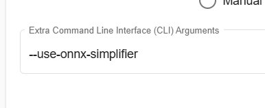

Im getting this error and dont understand the problem. I tried adding the suggested "--use-onnx-simplifier" from another post in the Web Command line but it didnt look like it took, here is the output:
>>> stedgeai analyze --model version-RFB-320.onnx --st-neural-art custom@/tmp/stm32ai_service/7f0992f6-31d1-46c4-892e-ecc0375878b5/profile-4de288e7-27c5-4d83-814b-a8f7038dc635.json --target stm32n6 --optimize.export_hybrid True --name network --workspace workspace --output output ST Edge AI Core v2.2.0-20266 2adc00962 WARNING: Unsupported keys in the current profile custom are ignored: memory_desc > memory_desc is not a valid key anymore, use machine_desc instead INTERNAL ERROR: Order of dimensions of input cannot be interpreted
I have also tried to use a transpose layer to order the inputs like [1,H, W, C] and that still caused this problem. Is there a way to have more verbose output then what i have, its not super helpful as to what to fix. I tried the transpose and spent lots of time figuring this out and to no evail, because it said it didnt like the order of the input. Please help, thanks.

  1. Re-export the PyTorch model → ONNX with --dynamic_axes set, making sure the input is [1,3,H,W].
  2. Run the onnx-simplifier locally before uploading:
    python3 -m onnxsim input.onnx output.onnx
    (sometimes the Web UI flag doesn’t actually apply simplification).

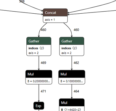

It seems that there is an issue in the node 469 and the st edge ai core generation:
I contacted the dev team to have more information.
I will update you when I get any news.

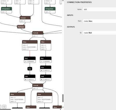

The specific issue for this model is the end attribute of the slice layer. The value is 9223372036854775807 which is MAX_INT64. The special case of 9223372036854775807 is recognized in some cases (not sure if it is for attribute, input or both) but MAX_INT64 is never recognized. To be checked but replacing it with 4 (the shape size on that axis) should solve the problem.
To comment on that, if you open the model with netron and look at the slice layer, you will see that the "ends" parameter is set to this max value 9223372036854775807.
You can try to use onnx and/or onnx graph surgeon to try editing the graph to set this value to 4 (in the log of the core, you can see that the value it was expecting was 4).

Ok I think I understand what you're saying, I'll try to change that to "4" and let you know, thanks for the update.
Julian,
Ok, I was able to make the changes to what turned out to be 3 Slice layers that had the same value, but now I see a new error and dont understand why its showing up. If I compare a Slice layer that I didnt change to one I changed I dont see anything different related to the error. Below are some points of interests that I separated using '=====....=====', Can you see anything wrong here? I used node_462 as a reference because i didnt change that. I also added the latest modified model. Also one important note is that this modified model works fine as expected in a jupyter notebook along with the original model before modifying it.
Thanks for you help, trying to get all this working for work using the N6 on a possible new product.

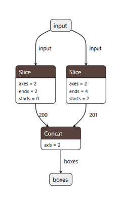

Julian,
Sorry for all this information, but its been bothering me that I fixed the first error and i get this other error that does not appear to be valid. What I did was make a very simple model with some Slices. I get this new error as my past post but here I can reverse the Slices and It does not Error out on the same Slice, it seems like its always pointing to the last Slice. If I reverse the order, it points to the Slice that passed before, this is what tells me its not making sense and it might be the tools chain. Also, please note AGAIN, the original models work elsewhere, even before making any changes. Below is the output of the simplified model.
C:\workspace\stm32_blaze_face>stedgeai analyze --model slice_example.onnx --st-neural-art --target stm32n6 --optimize.export_hybrid True --name network --workspace workspace --output output

INTERNAL ERROR: node_200 of type Slice has not parameter orig_steps. Available parameters are dict_keys(['orig_axes', 'orig_starts', 'orig_ends', 'starts', 'ends'])
Julian,
Sorry again for all the messages, but I have been trying to use this model for a long time. I finally got it to generate the N6 code. What I was able to do was change all the Slice's to Gather's. I personally think the toolchain has an issue with Slice even though its fine. I have not tested the code on the N6 yet, but have tested the output model from the stm toolchain and it still works on my jupyter notebook, so have confidence, ill update the post with the results. This is what the replacements look like.
If you can keep me up todate on the Slice status that would be great.
