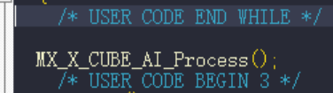

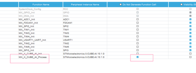

1.I chose not to generate calls when generating code in cubemx, but it actually needs to be generated. Also, this cubemx is written in Java and always pretends to be dead. My computer is a high-end Intel i9, so it's impossible for the software to run slowly

I think you can select none as template when activating X Cube AI to solve your issue.

1. I am using cubeAI and you asked me to choose none. The H5 model I am using has compression model function as mentioned above, but it was not compressed in actual testing. Moreover, your version is still an old problem, and every time the motor AI module forces me to modify my clock configuration. I mentioned this issue last time, it was resolved by forcing file modifications, but the problem still persists with your new version. There is also the issue of Cube choosing to generate code. I clearly chose not to generate calls, but it is still generating calls. I don't know what ST is doing now. It is an obvious problem, just not changing and being arrogant.
