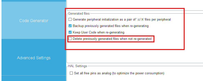

When regenerating using STM32CubeMX, please verify these settings:
Best regards
Yanis
@hamitiya As suggested by you, I started the project in AI studio from scratch and generated the IDE project . I opened it in STM32 IDE and build the application code in it. It got built without any errors. Then I opened its Cube MX file to add the parameters I want for example ADC- I added it in application mode and took care of above settings in code generator . But after pressing generate code in its cube MX file, It still removed the AI headers from application and made changes automatically in studio AI files.
This is the problem coming again and again. That is why I tried downloading only C code from studio also so that I can add my project with it, but that is also failing.
