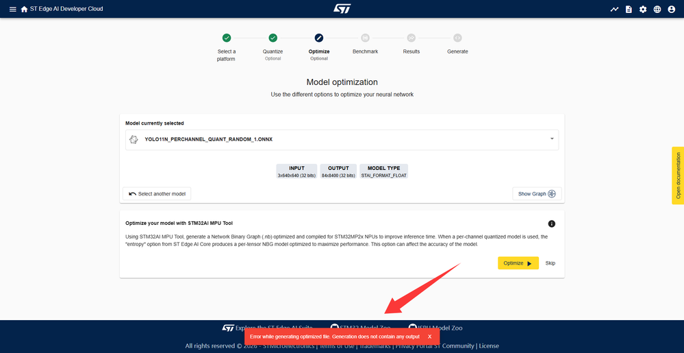

My development board is STM32MP257F-DK, and I want to use ST Edge AI Developer Cloud to convert. onnx models to. nb models. However, during the interface conversion of 'Optimize your model with STM32AI MPU Tool', an error message 'Error while generating optimized file. Generation does not contain any output' was reported. Afterwards, I will use the model provided by ST Model ZOO: st_yoloxn_d033w_025-416_qdq_int8_ort_detection_CCO_2017_Serson. onnx. I also encountered an error while optimizing. What is the reason behind it? A few days ago, I was able to successfully convert ssd_mobilenetv1_pt_coco_300_qdq_int8_ort_detection_CCO_2
The error message is as follows:

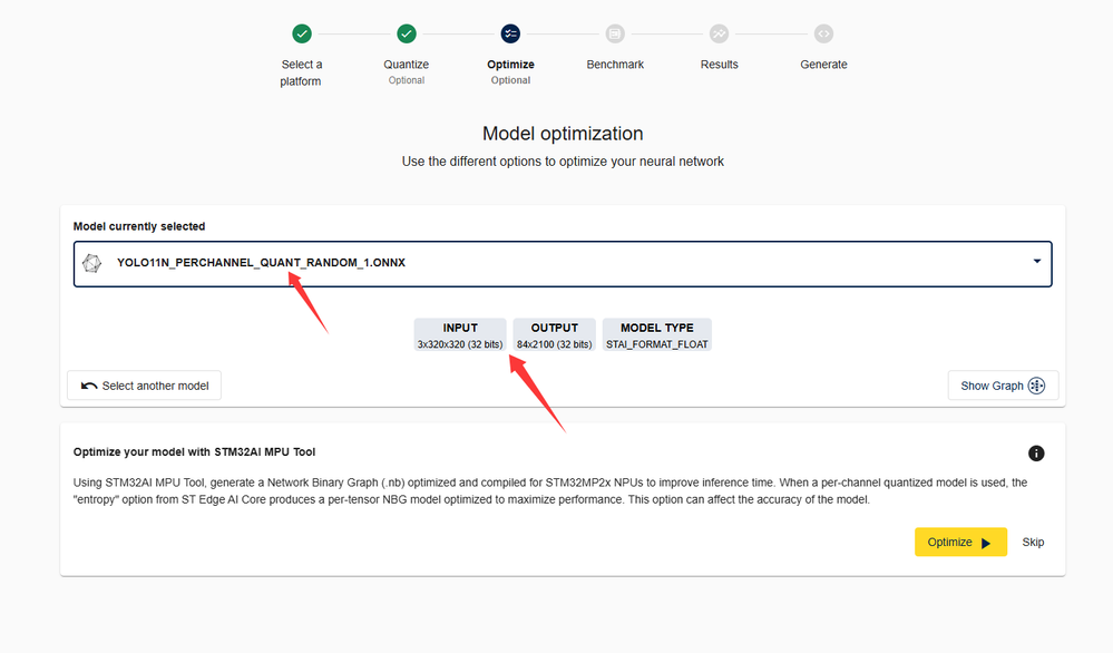

Then, on the ST Edge AI Developer Cloud, the quantization is int8, but it still shows that the input and output are 32-bit. And there are also errors when optimizing...

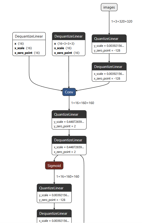

Using netron to view yolo11n_PerChannel_quant_random1.onx, it can be seen that it has been quantified:
I have put the onnx model and quantized model of yolo11n in the 7z compressed file. If needed, you can download and view them

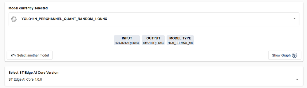

Information on the top of ST Edge AI Developer Cloud is from the original model. It won't refresh if you switch from the original to the quantized one. To actualize it, you should go back to "Home" and start with the quantized one:
Model is then correctly quantized.
However, as you mentioned, quantized model is not able to run on MPUs. The source one runs correctly on STM32MP257F-DK.

The error generated by STM32 MPU tool is the following:
E [ops/vsi_nn_op_eltwise.c:op_check_add:466]Inputs/Outputs data type not support: ASYM UINT8, SYM INT8
E [vsi_nn_graph.c:setup_node:551]Check node[134] MULTIPLY fail
Best regards,
Yanis
