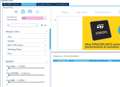

Thank you for your quick response. I followed the instructions in the document However, the board STEVAL-MKI109V3 has not been added to the system. as you can see below picture.
@Evelina CAMILLERI Ideas?
