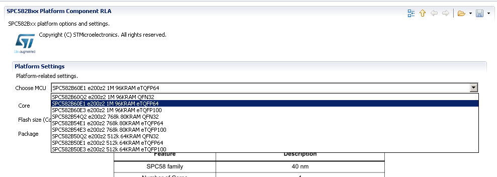

Although SPC582B family has up to 7 FlexCAN modules, some units have only 3 (i.e. SPC582B60E1CD00X).
Which 3 of 7 CAN modules are available in this processor?
Since SPC5Studio shows 7 CANbuses for this processor, I don't know which I/O should I design for CANbuses.

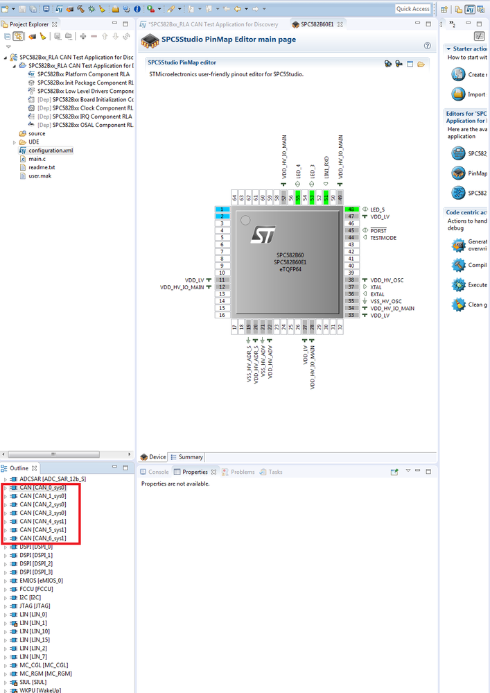

Yes , in SPC5Studio , we are seeing 7 Can Buses
You can use the Pinmap Wizard in order to determine which I/O Buses are designed for CAN Bus
It is very useful.

Unfortunately, in this case, I cannot use SPC5Studio to see which I/O pins are designed for CANbus in SPC582B60E1CD00X.
SPC5Studio shows that this processor has 7 CANbuses, while actually it has only 3.
In SPC5Studio there is no choice between SPC582B60E1CD00X (3 CANbuses) and SPC582B60E1MH00Y (7 CANbuses):
