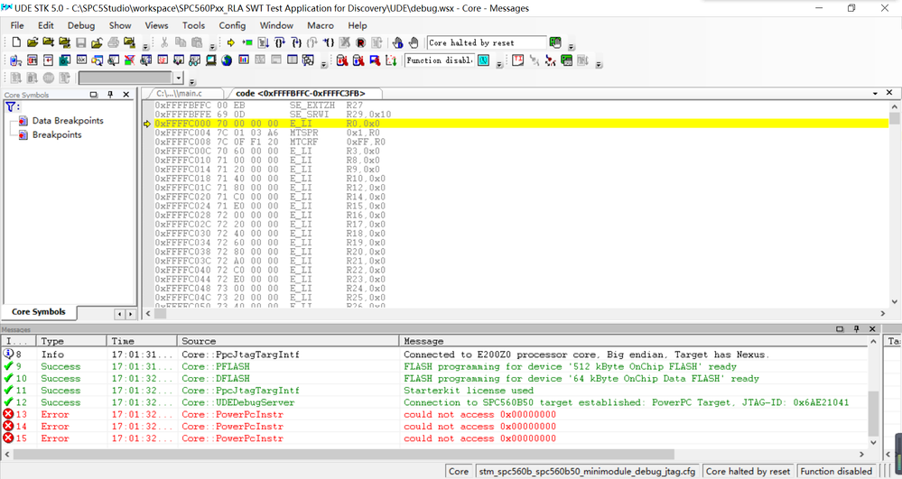

My setup:
SPC560Pxx_RLA SWT Test Application for Discovery
uC: SPC560P50L3
IDE: SPC5Studio 5.8.1
This problem occurs when emulator links. Tu 21.04.2020 16:07:54.541, Error, Core::PowerPcInstr, could not access 0x00000000

Our program can run when connected to the debugger, but it can't run automatically when unplugged and recharged. What's the problem?

Hello ,
Do you use PLS Debugger or TRACE32 debugger ?
have you flashed your software ?
Could you check your jumpers ?
Best Regards
Erwan

- The board I used was designed by myself, and there is no problem with the reset electricity.
- The emulator I use is spc5-udestk-eval.
- To make sure my program is working properly.
- An error occurs whenever the emulator links to the board.

It is a matter of emulator configuration. Check the configuration files.

- Since it is not clear for me to use it for the first time, could you please tell me how to configure it in detail?Or do you have any recommendations?
- As shown below, what is the reason for this?(i.e. Error, Core::PowerPcInstr, could not access 0x00000000)
