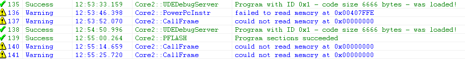

Hi I am using SPC5 studio as workbench, UDE STK as debugger.
while debugging am getting the following warnings.
please help me to configure the UDE STK.

Hello Chandika ,
First, debug is OK on your target.
i think that you have launched the call frame window and PLS UDE is trying to link Address function to your elf file (Symbol file)
it could be a crash in your program.
check the LR and try to break the program before the crash
could you send me your full screenshot to have a state of the CPU ?
which version of PLS UDE do you use ?
Best regards
