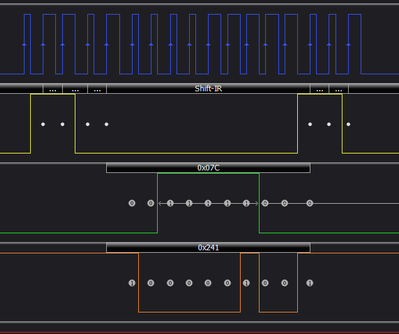

I through Nexus to read/write memory.Is the response correct?
The steps to enter Nexus from jtag are as follows:
1. TDI: Shift-IR(0x01) Shift-DR(0x00000000) TDO: 0x11140041
it confirms the jtag id is correct
2. TDI: Shift-IR(0x2A)
it through jtag to enable access to E200 Core 2
3.TDI: Shift-IR(0x7C)
