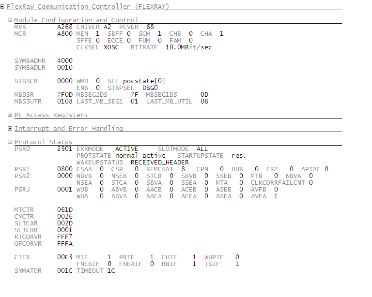

We are facing some difficulties with FlexRay driver development for SPC564A80B4.
  • We can able to configure the Protocol Control Registers (PCR0~31) for FR configurations, so that ECU and FlexRay module successfully able to move to Normal Active state of Flexray communication.

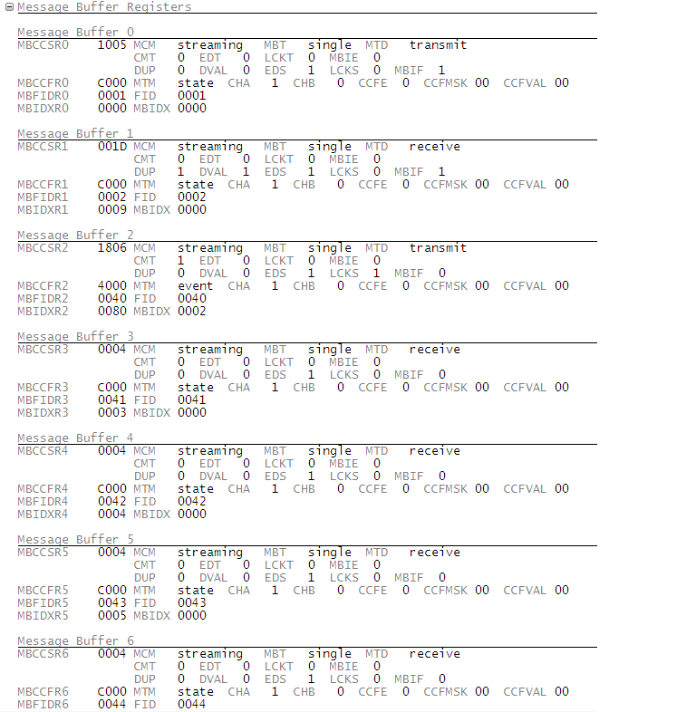

  • Also message buffer configurations for Transmission and reception is also performed according to number slots.
  • Tool (CANalyser) is also configured with the same flexray configurations as ECU.
  • Now, when we are sending a frame from ECU in slot 64 (dynamic slot).
  • But we observed frame error/ SERR error in the CANlyser window, also payload length is observed as zero and slot ID is 64 is visible. (Please find the attached error snapshot SERR_error.jpg)
We would like to know what can be the possible reasons for this error.
Please let us know if any additional information is required.

Hello Manesh ,
According to the RM, in the chapter 33.4.2
If the protocol engine is clocked by the internal PLL, the frequency of the PE clock source is
system clock / 3. The system clock frequency has to be 120 MHz.
Did you clock your protocol Engine Clock ? on-chip crytal simulator or PLL ?
CLKSEL
Protocol Engine Clock Source Select �? This bit is used to select the clock source for the protocol
engine.
0 PE clock source is generated by on-chip crystal oscillator
1 PE clock source is generated by on-chip PLL
Have you checked the different Status Register , Message Buffer Status Error and Channel A/B Status error?

Hello Erwan,
We using ext-crystal osc of 40Mhz as a PE clock.

Hello Mahesh ,
Honestly , you should try to solve your clock configuration (loss of clock) first because a timing issue on Flexray ip could trigger some synchro issues.
https://community.st.com/0D50X00009XkYOySAN
Did you use official AutoSAR Flexray MCAL driver ?
or it is your own driver ?
