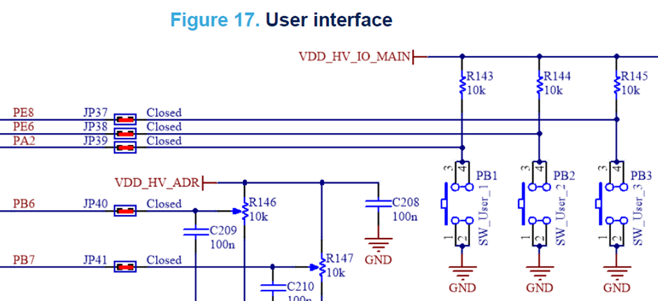

Open the board User Manual UM2697:
You can see that push button 1 (PB1) is connected to MCU port PA2.

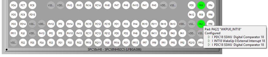

In SPC5Studio, open the Pinmap Wizard in your application:
You can see that MCU port PA2 is configured as interrupt input WPKU0_INT18.

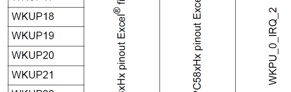

Open the Reference Manual RM0452 and look to table 51:
You can see that WAKPU0 module interrupt WKUP18 is mapped on WKPU_0_IRQ_2.

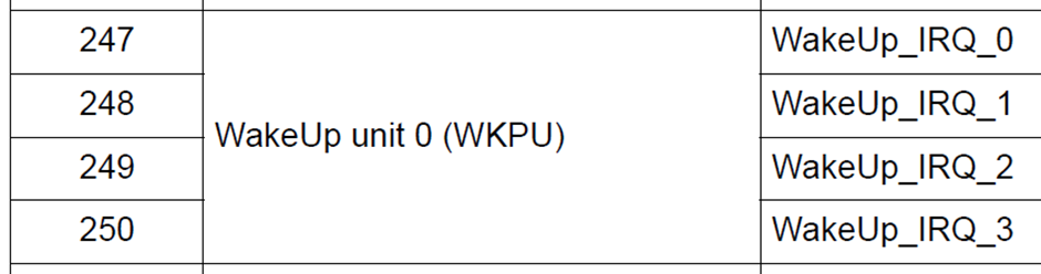

Then look on table 37:
You can see that WKPU0 IRQ2 is mapped to MCU External Interrupt 249.

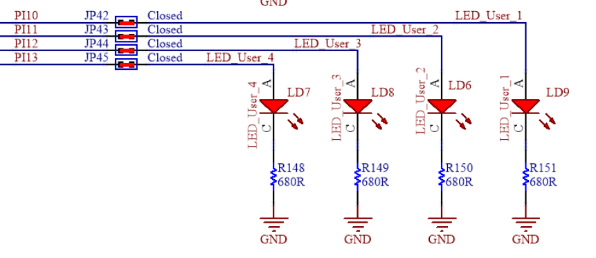

So according to the code, when pushing on Button1, You should toggle the LED2 mapped on MCU port PI[12]
_legacyfs_online_stmicro_images_0693W00000bhxg0QAA.pngso it is LD8, connected to JP44
This is not in line with demo README file...

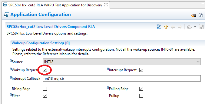

One more question related to the wake up example!
It's about examples.-> "SPC58xHxx_cut2_RLA_WKPU Test Application for Discovery"
When I run the example, it worked successfully.
When the RUNMODE of SPC5 is set to STOP0 and the SW_1 button is pressed, the board successfully transitions back to RUN mode.
I created a project to replicate the same behavior, but the SW_1 button press did not transition the mode to RUN as expected..
Is there anything that needs to be configured to make the SW_1 button transition the mode to RUN?
I compared the example code with my project and made the necessary configurations. If there are any other areas I should check, please let me know....
maybe you forgot to activate de wakeup request in Low Level Driver configuration ?
