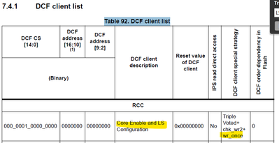

In attach you can find the script to program a DCF record with StellarLINK to enable boot from Flash at the USER VTOR ADDRESS.
Please follow these steps in order to configure the device by programming the DCFs in UTEST area:
  1. Copy the script "SR5E1_SDKE_VTOR_ADDR.cfg" in C:\StellarLINK\openocd\scripts\utility
The script searches the first free address in the UTEST area and here programs the value 0x0200000C08000000:
  • USER VTOR ADDR DCF: &0x0200000C.
Refer to the Table 92. DCF client list in the section 7.4.1 DCF client list of RM0483 rev5.
  • User VTOR Flash address: for example, 0x08000000.
Note: the search in UTEST area configured in the script is only an example and starts from address 0x1FF8_0388.
The first free address on a virgin production SR5E1 sample is at address 0x1FF8_0398, that is the "UTEST DCF Records".
  1. Run the script from command line :
C:\StellarLINK\openocd\bin\openocd.exe -d0 -s C:\StellarLINK\openocd\scripts -f utility\SR5E1_SDKE_VTOR_ADDR.cfg
  1. The update of VTOR ADDRESS or to program another DCF, simply change the value at line 77 in the script.
To enable the Lockstep feature, program the 'Global System Configuration DCF', that is:  0x0200000000000100
  • Global System Configuration DCF: &0x02000000,
  • LS_CORE1_2=1 (Lockstep for Core1 and Core2 enabled - Lock configuration): 0x00000100.
Note: the SR5E1 is affected by DAN-0055207, therefore the setting of LS_DMA=1 has no effect. The DMA subsystem is always in lockstep mode.
First complete the device configuration, by adding the required DCFs, then program the code in Flash.

FSPIL
The LockStep feature is permanent because the Global System Configuration DCF is write once.
Please refer to Table 92. DCF client list, the first item.
The user can write more times the Global System Configuration DCF but the next writes are dummy, only the first value is recognized and applied.
regards,
