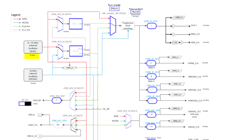

In our project, we are using a 20Mhz external crystal oscillator. The default frequency of external oscialltor in SPC5 Studio CLock Tree editor is 40Mhz. How will I change it to 20Mhz? Please see the picture below.
Br,
Sreejith

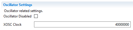

click on Clock Component:
then on oscillator setting in outline:
You will reach the oscillator settings in the main window:
Then change it to 20 MHz and you will have to adapt all your clock tree using reference manual according to your new external clock.
Best Regards,
-Olivier
