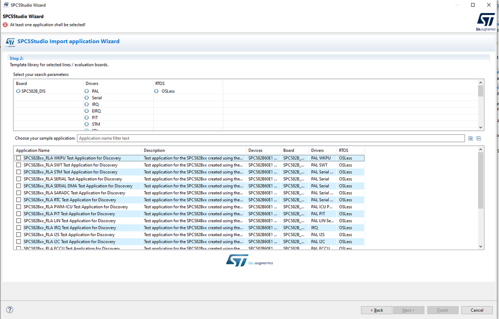

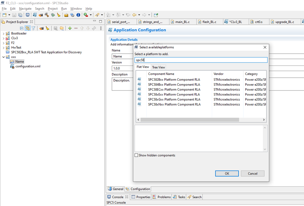

Hi Sebastian,
Example from SPC5Studio sounds like exactly what I need, but unfortunately I can't find it.
When I create new project and press green "+" icon, I can see only regular RLA platform components:
0693W00000aIekyQAC.pngWhen I try to get through "Common tasks" --> "Import samples from application library", there is also nothing related to "boot loader" in following view:
0693W00000aIehHQAS.pngAm I missing something? I have SPC5Studio 6.0, which seems to be the latest.
