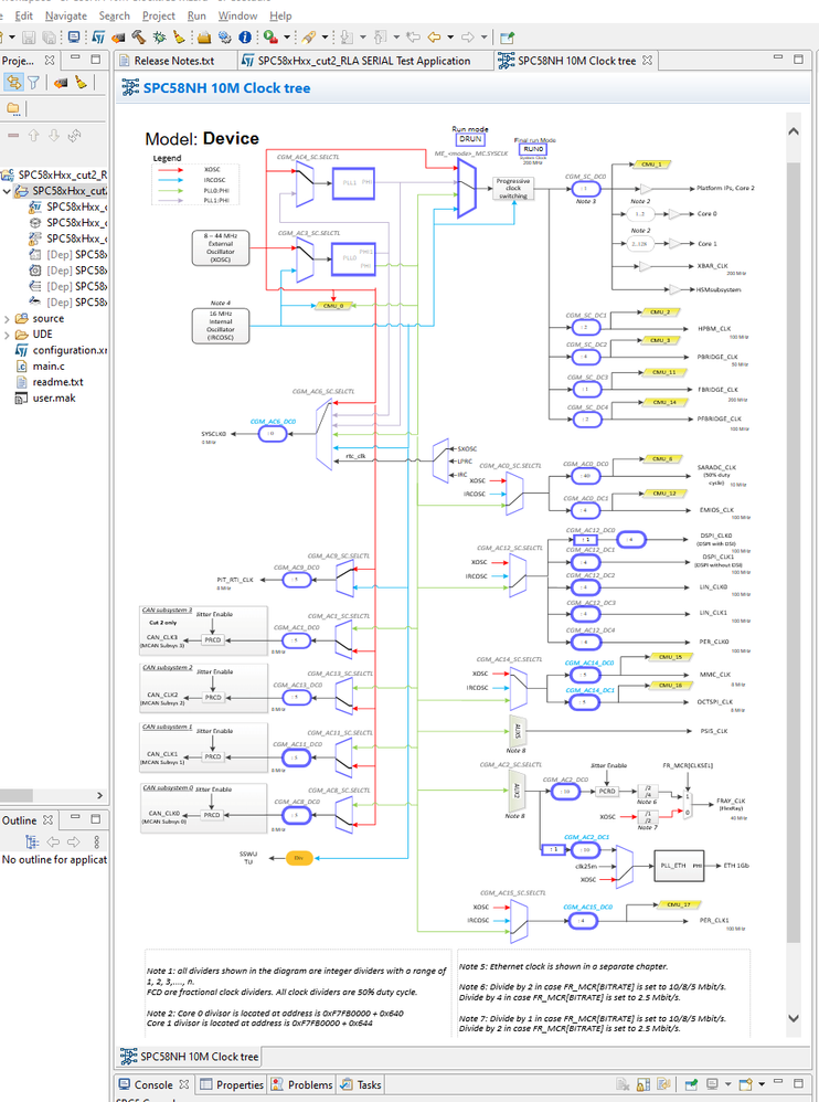

Hello Alexandre ,
Normally , this CPU is based on Triple z4 cores 200 MHz
to calculate the MIPS , you should have :
MIPS = (CPU Frequency in Hz) / (Number of clock cycles per instruction)
On the different IPs, you can check the clocktree
     Best Regards
                    Erwan
