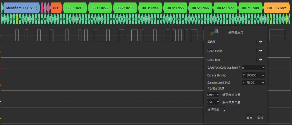

Hi all,
Could you check this problem for me? It can not received information from canoe, data(from transceiver) already reached RX pin of SPC5.​
The data transmit from Conoe is : ​
The source code in Attachment.
​I use external OSC is 8M.
CanBitRate is 500 kbps.
Thank you very much.

Hi ​Erwan,
Thank you for your reply.
The problem and the solution is that the circuit on the TX side is not connected.
