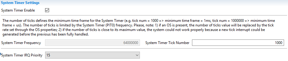

When I call this function osalThreadDelayMicroseconds(1u), I found that 1us is not implemented, and the actual result is 1ms.
But if you call osalThreadDelayMicroseconds (9000u) it can reach 9ms.
The parameter usec is less than 1000 and is 1ms.
May I ask why I can't achieve 1us?
I used 1000 for system timer tick number:​

As the recommandation, the number of ticks is limited by the system Timer (PIT0) frequency
Do not hesitate to go to the RM in order to check the PIT Limitation.

I think the system is running at a millisecond level, and it doesn't work through the osalThreadDelayMicroseconds function.
Do you have any better suggestions? Or can you implement subtle delays in assembly language?
