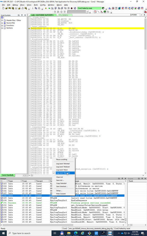

I would like to know how to increase the log value in the PLS UDE
PrasannaMurali26
we need to know that how to increase the log value in the "PLS UDE " we are currently using the SPC56P board and spc5studio along with that we are using UDE STK 5.2 for the flashing.
Erwan YVIN
You can increase the log level (cf screenshot) in Messages Section.
(Second Button)
Best Regards
Erwan

as this log buffer is managed by UDE tool from PLS Company, did you asked to the tool provider ?
