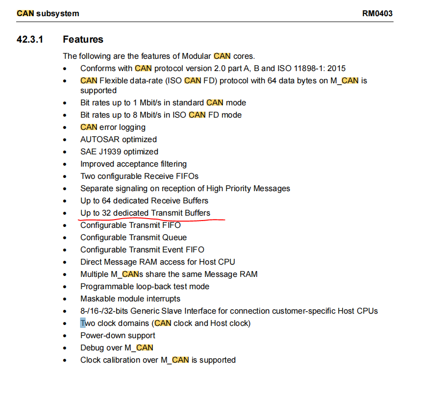

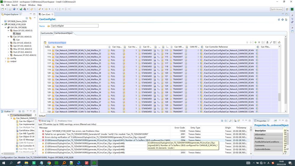

When we are using SPC582B MCAL, we see that the manual only supports 32 Transmit Buffers for one way CAN, but we need to use 38 Transmit Buffers on BCAN. When I import ARXML into EB and generate CAN configuration parameters, EB will report an error. Do you have any good suggestions? thanks
