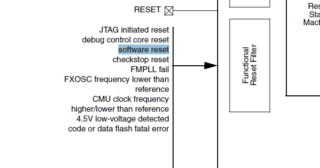

how to generate software reset in SPC 56D40?

Hello bhargaviparalikar,
Use ME register to generate a software reset
/* Starts a transition process.*/
ME.MCTL.R = SPC5_ME_MCTL_MODE(0) | SPC5_ME_MCTL_KEY;
ME.MCTL.R = SPC5_ME_MCTL_MODE(0) | SPC5_ME_MCTL_KEY_INV;
Best regards
Erwan

‎2022-04-12 12:51 PM
hey Erwan, when i try this; mcu is going reset but not starting again. i tried with 0x0000(reset) and 0x1111(destructive’ reset).
should i off something manually before reset?
