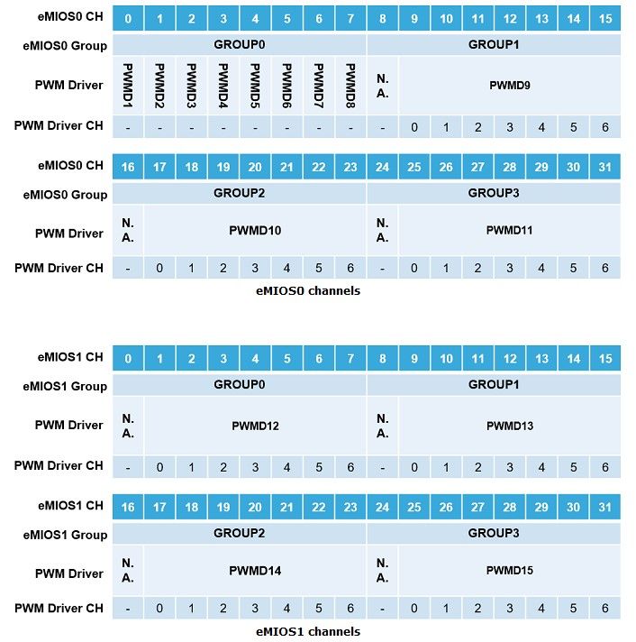

    I want to have a easy and simple PWM at pin 6, eMIOS0-UC4. I used the pinmap editor to assign it to eMIOS 0 channel 4, set it to active low.
    I call
    pwm_lld_start(&PWMD5, &pwm_config_PWM0); during startup and afterwards
    pwm_lld_enable_channel(&PWMD5, 0, PWM_PERCENTAGE_TO_WIDTH(&PWMD5, 5000), 100, 0, 0);
    But the pin sits idle at 5V without any change.
    Is there any documentation regarding the tons of options available in the GUI? I found a few help files under components\spc58ecxx_low_level_drivers_component_rla\doc, but the don't help that much.
    Thanks.

    thanks for your reply. After some confusion I was able to find the PWM-ICU application, because it is for a different type of microcontroller. Upon looking through the code I found that I was doing the exact same steps.
    Ultimately I found the problem: The clocks and dividers where set up in order to produce a PWM width of one tick. I configured it to 50% duty cycle, and 50% of 1 always yielded 0. After adjustig the clocks and dividers, it is now working.

    Right now I am back at the PWM problem again. I want to use pin 11, eMIOS0_UC8 or as a fallback eMIOS1_UC10.
    eMIOS0 group0 ends at channel7, so it has to be group1. It generates code for PWM driver 9, OPWMB, and I call the same function but replaced PWMD5 with PWMD9 and the config with a duplicate and adapted version of the working config. The pin sits idle at 2,5V.
    How can I find out why UC8 is not working?

    as specified in the User Manual within the folder doc of the Low Level Driver Component, between the eMIOS channels and the driver instances there is the relationship summarized in the following picture:
    0693W000007ZiakQAC.jpgAs you can see from the picture, the channel eMIOS0_UC8 is not available. This because, except for the first eMIOS group (eMIOS0 group0), the first channel of each group is used as counter for the other channels of the same group. So, for example, the channel eMIOS0 ch8 is the counter for the channels eMIO0 ch9-ch15. These channels (eMIO0 ch9-15) are managed as a unique driver (PWMD9) with 7 channels (0-6) with the same period. If you need to use the eMIO0_CH8, the driver must be modified.

    Thanks for your reply. Like I said, as a fallback I'd be ok with using eMIOS1_10, which is the same pin. According to the spec, that would make it PWMD13, channel 1.
    So I configured it to UC10_1 in the pinmap editor, called:
    pwm_lld_start(&PWMD5, &pwm_config_BR0_PWM);
    pwm_lld_start(&PWMD13,&pwm_config_BR1_PWM);
    And afterwards
    pwm_lld_enable_channel(&PWMD5, 0, PWM_PERCENTAGE_TO_WIDTH(&PWMD5, 5000), 0, 0, 0);
    pwm_lld_enable_channel(&PWMD13, 0, PWM_PERCENTAGE_TO_WIDTH(&PWMD13,5000), 0, 0, 0);
    The call for PWMD5 works, I get a PWM at pin6. The configs are identical, ~39kHz PWM frequency and set to the respective eMIOS group & channel.
    Where should I look for errors?
    zambrano.luigi
    March 1, 2021
    as said before, the PWD13 is a unique driver that manages 7 channels. So, if you want to enable the channel 1, you have use the following enable instruction:
    pwm_lld_enable_channel(&PWMD13, 1, PWM_PERCENTAGE_TO_WIDTH(&PWMD13,5000), 0, 0, 0);

    Aww damn that copy & paste. Sorry, my bad, it is working now. Thanks for your help!
