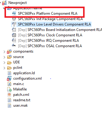

before that we are analysing the SPC Envoinment for that i downloaded the SPC5 studio in that we have some quries
1.First from some documentation i found that create a SPC5 project then in the Screenshot (i added the component to the SPC560pxx Platform Component RLA) 0693W000005B1x7QAC.png2.Can anyone help me how to configure the GPIO,UART,SPI etc and generate the drives is any documents available or any video refernce for SPC560p controller

Giuseppe DI-GIORE
clicking on SP560Pxx Low Level Drivers Component RLA
will open a configuration panel for all device drivers supported on SPC560P (UART, SPI, CAN, etc).
do not forget to open also the Outline view required to configure the drivers.
To configure the GPIO you can either:
  1. open the PinMap wizard and configure each single pin
  2. click on SP560Pxx Board Initialization Component RLA and configure the GPIOs
Have a look at the following tutorials (ignore AutioDevkit which is not supported by SPC560P):
