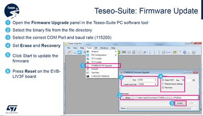

Also, please ensure, that GNSS2A1 is running the latest firmware. You can download latest firmware here, https://www.st.com/en/embedded-software/teseo-vic3dsw.html
You can use Teseo Suite to upgrade firmware.
Go to Tools > Teseo FW Upgrade.
Attached is a reference on the procedure. This picture was from an older  version of Teseo Suite but the fields are the same.

Important news. I removed the jumper connected to J27 and J28 and then i connected a UART to USB cable J27-Pin2, J28-Pin2 and GND and next i opened teseo suite and the coordinates were correct, how you can see in the attached files.I downloaded latest firmware and i tried to update, but it failed (in the attached files you can see the settings as specified in the procedure). Now I can no longer see the coordinates and previous results. I hope you can help me and thanks for your availability
