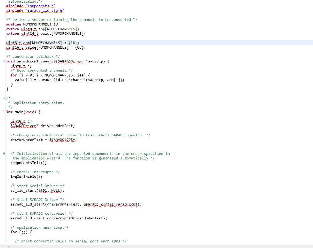

Hi Erwan,
i'm using SPC57 (SPHAERO). Which one i need to select?
‎2022-07-01 01:30 AM
what is different between "saradc_lld_cfg.h" and "adc_lld_cfg.h"? i got confuse between these two.
‎2022-07-01 01:53 AM
saradc_lld_cfg.h is the only one used on SPHAERO product, do not mind about other.
‎2022-07-01 02:03 AM
What means by {8U,9U} and {0U,0U} ? One more thing whats is "anp" stand for and function?.
‎2022-07-01 02:16 AM
be careful, you are not looking to the SPHAERO demo (SPC574S) but to the VELVETY one (SPC570S) do you confirm you product is SPC574S ?
‎2022-07-01 02:18 AM
U is used to define unsigned immediate for MISRA purposes
anp, I suppose it stands for analogue port ? as it is used to select analogue channels
‎2022-07-01 02:23 AM
oh i think i wrongly open the VELVELTY one. is it this one for sphaero line (ref pic i send) ? yes i confirm my product is spc574s
