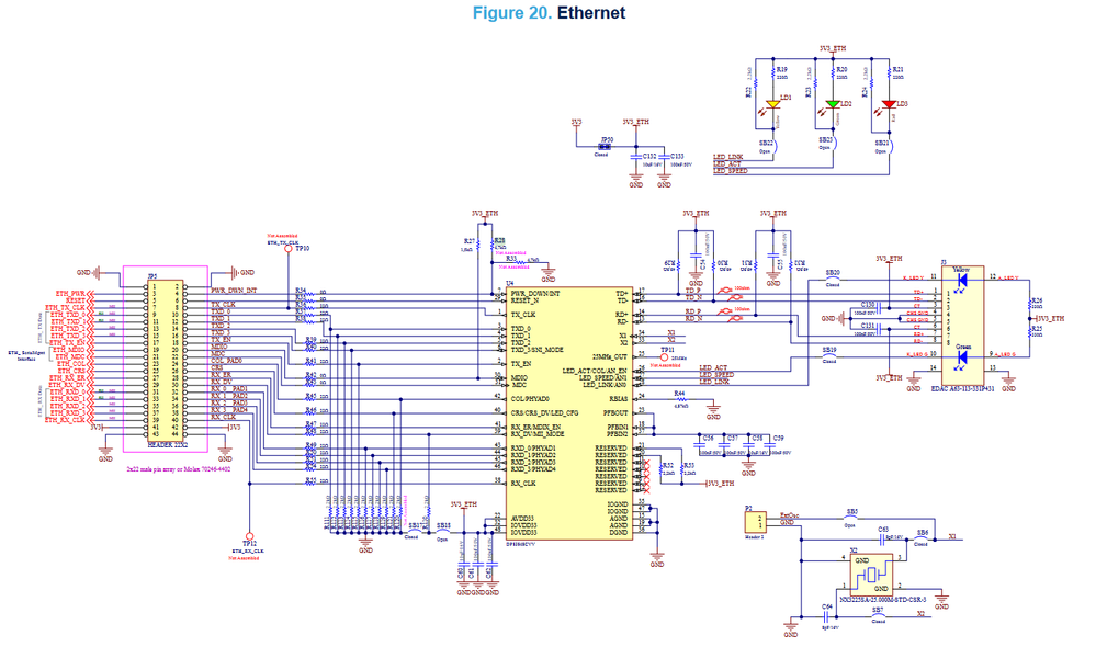

Do I need to complete the components on the SPC58EC-DISP development board?
Not applicable
0693W00000Nq1klQAB.pngIn the schematic of the ethernet configuration it is indicated that 3 components are not assembled: R28, R33 and R120. My question is, should I solder them for it to work?

Giuseppe DI-GIORE
no need to solder any resistor.
Please close the jumper in connector JP5 from 5 to 39.
Regards.
I'd expect not. Would depend on what pins you end up using on the interface. Watch PWR_DOWN/INT and COL/PHYAD0
The JP5 needs to have pins being used for the MII/RMII bridged (jumpered).
Check any related README.TXT notes or comments in the example code.
Still doesn't work, even the leds of the RJ45 connector don't turn on

Is JP50 powering the Ethernet side hardware?
Probe a couple of points checking you get voltage and can see clocks.
Not applicable
Yes, the JP50 is correct. And i have the clock pulses. Now, after reprogramming the leds are blinking, but I can´t ping
