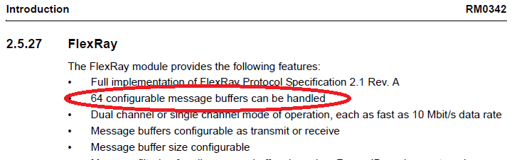

    I suppose you still working on SPC56xL70 so the reference manual is RM0342
    you can see in Table 327. FlexRay memory map (Sheet 1 of 4):
    there are not 32 but 64 slots of these registers MBCCSR/MBCCFR/MBFIDR/MBIDRX
    Best regards.

    Concerning the number of buffers, the document is clear:
    0693W00000Nq7EBQAZ.pngthere are 64, no more
    concerning the slots, what are you talking about ?
    BRs
