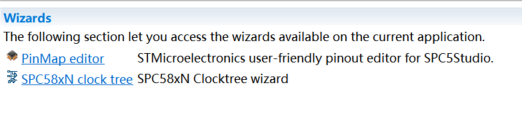

when i configure spc58nn project ,there is pineditor and clock tree ,the configurtion gui. and i cant find any other peripheral configuration gui,any one know this?

did you import an existing SPC58xNxx project ?
or did you created a new SPC58xNxx project ?
What would you need that you do not see ?
Best Regards.

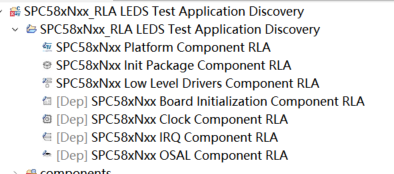

Select the Platform component and click on the Green "+" to add others components (Init and LowLevelDrivers)

i import example project,there are only two items above,and i want to know if there is any other peripheral wizard,such as canfd ,SDADC or GTM and so on.
‎2022-09-27 12:29 AM

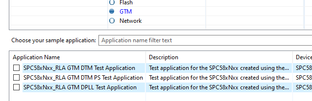

There are no other Graphical tools.
To configure SDADC or CAN, you need to add and configure the Low Level Drivers component:For GTM, you need to add and configure the GTM component:
You can take a look at GTM examples:

‎2022-09-27 12:52 AM
I can see low level Drivers component RLA,but i cant find GTM compennent==
‎2022-09-27 01:00 AM
select platform:then click on +:
then select GTM:
‎2022-09-27 01:12 AM
thank you very much :grinning_face:
