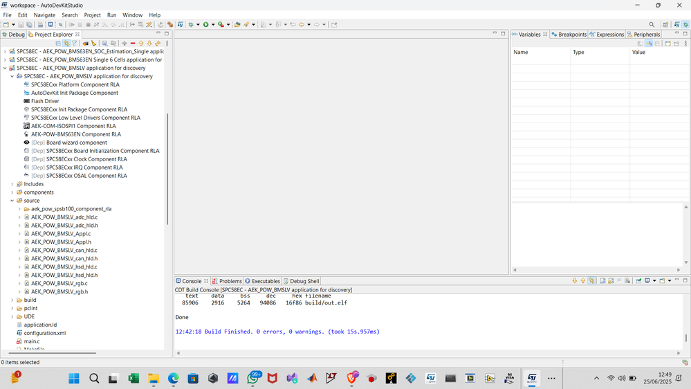

June 25, 2025
i follow all the steps, i have this on my pcScreenshot 2025-06-25 124915.png
June 25, 2025
Hi Alfonso,
the screenshot I see in your post is correct.
Now, you have to follow Section 4.3 How to program the SPC58EC80 microcontroller as written above to debug the MCU.
You need the dongle as written before: "You should buy a dongle (e.g. AEK-MCU-SPC5LNK: https://www.st.com/en/product/AEK-MCU-SPC5LNK ) to program the onboard MCU."
Then, read section 4.4 AEK_POW_BMSLV_Demo_Code
"The purpose of this demo is to show how to read the voltages and temperatures of a 48V battery pack (14 cells)
and how to address the high-side power drivers of the VNQ7050 by monitoring their current consumption through
a sensing network with a specific fR_sense value..."
Of course, as you cannot use this board with the GUI, you will need a serial terminal to read voltages and temperature.
I hope this helps :)
BR,
AutoDevKit team
