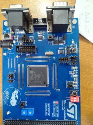

All the jumper settings ok??

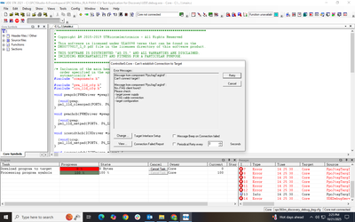

as i have installed UDE starter kit 2021.05
and getting error  attached in pic. below
This is an old board I am not familiar with, therefore I am not sure about the jumpers.
On the other side, PLS is trying to access the board and somehow it cannot.
So, two simple points to check:
- Is the board turned on and properly connected?
- are the FTDI drivers properly installed in your Windows? Have you checked if the USB port is recognizing the PLS UDE?
