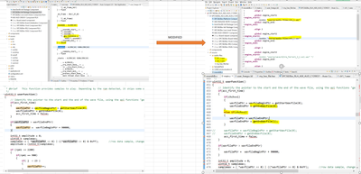

We are working on AVAS project Autodevkit AEK-AUD-C1D9031 and trying to execute two wave files for two different channels.
But only one wave file is getting executed which is getStartWavFile(0) when tried to give non zero parameter ,wave sound is not coming e.g. getStartWavFile(1).
Below is the snippet base code and modified code to access both wave files:
1.Two wave files added inside source -->audio files
2. Two wave files location has been added inside sounddb.s
In the previous post I have provided a complete code taken from AutoDevKit Studio sample library.
It has 2 tasks and delay. Try it first and then try to understand the difference with your code.

Hi Max VIZZINI,
Thank you for your prompt and informative response to my previous inquiries posted in the community. Now, the source code is working fine for two channels with two different wave files.

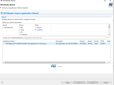

Now I am facing one more issue, I took FreeRtos example(as shown in the snippet) as the base source code and integrated AEK-AUD-D903V1 RLA component. After integration, "AEK_903D_Init(AEK_AUD_D903V1_DEV0)" API is not getting initialized. The execution is getting stucked inside this API.
Can you please help me to come out of this issue, so that I can integrate FreeRtos and amplifiers together.

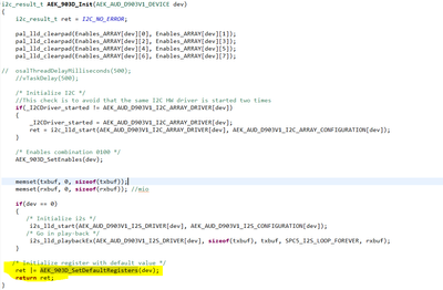

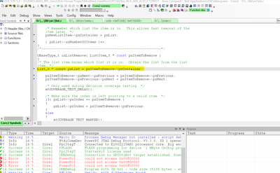

Hi Max VIZZINI,
A very Good morning, Thank you for your support and guidance.
Basically, I have not added any base new sound files to the existing source code.
I have modified the source code as you mentioned but I am again facing the following issue, can you please help me to come out of these.
1. If I use vTaskDelay() or vTaskDelayUntil (), Execution is getting stuck at "List_t * const pxList = pxItemToRemove->pxContainer;" line in uxListRemove() API(As shown in the snippet).
2. If I comment vTaskDelay() or vTaskDelayUntil (), then execution is getting stuck at "ret |= AEK_903D_SetDefaultRegisters(dev);" line in AEK_903D_Init() API(As shown in the snippet).
You are calling a vTaskDelay() primitive without creating a task and without starting the scheduler?
If so, no surprise the task handler does not find any active task...
You CANNOT just add freeRTOS components and some primitives and hope everything works: you need to CHANGE the ENTIRE code to run under an operating system.

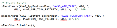

Hi Max VIZZINI,
A very good afternoon, Thank you for your informative response and guidance.
Actually I have created two tasks with different priorities(as shown in the snippet) along with the task scheduler.
But still execution is stuck inside delay function.
Can you help me to come out of this issue
Thanks for understanding
