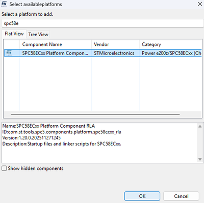

  3. Search for "spc58e", select SPC58ECxx Platform Component and click "OK"SRomeo_2-1776090843256.png

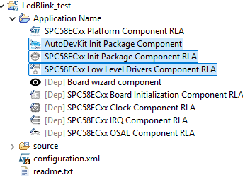

  4. Add "AutoDevKit Init Package", "Spc58ECxx Init package" and "SPC58ECxx Low level drivers" as well.
    All other AEK components will be added automatically:

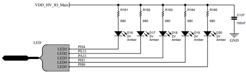

  8. Now, in order to allocate the correct pins. you need to understand which are the MCU pins wired to a LED for your board.
    You are using an AEK-MCU-C4M3A so take a look to its schematic.
    As you see the board is equipped with 5 LEDs, which may be driven by means of 5 MCU pins.

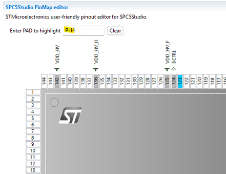

  9. Click on the search bar (on the top-left corner)
    and fill with the name of the port/pin combination:
    The pin will automatically be highlighted in blue.

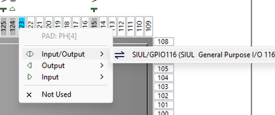

  10. Right click on the pin and select:  Input/Output -> SIUL/GPIO
  11. Click on Save (Top-left corner) and close the Pinmap Editor.
    Now your MCU pin is allocated.
