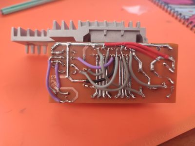

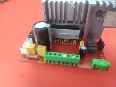

I bought this chip and pcb circuit from the internet, then when I plugged all the components into the pc and powered it up, I couldn't get any sound. When I powered up the circuit, it got hot inside, but only a low sound came from one speaker pin, but it didn't reflect the sound I gave to the speaker in any way. Also, this heating situation happens when there is no st-by short circuit. When I checked it with the short circuit-diode stage of the multimeter, when I filled the capacitor a little and touched the legs of the channel with low sound to GND, it showed a short circuit and stopped after a while, so I think there is a short circuit between the power input and the channel with low sound, and when I touched its negative end to GND and the other end to the output of the channels, I see 600 in the outputs without low sound, while I see 70 and 100 in the channel with hiss. These are what I found for now, thank you very much if you can help. Also, I want to ask something, do we need to short-circuit the st-by and mute pins and leave them or do we need to keep them in the short circuit position when we use them?

I took the PCB from the layout in the datasheet and arranged it myself and printed it.

AScha.3
July 13, 2024
Show a pic from your amp construction .
And a link, what you bought .
