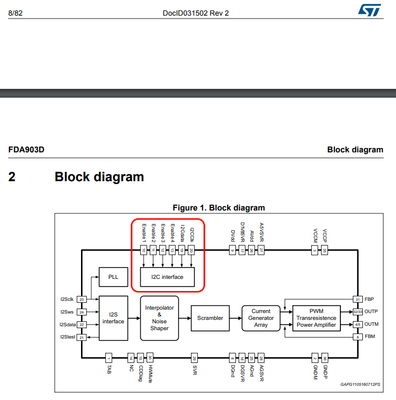

Hi, i have a AEK-AUD-D903V1 evaluation board, speaker. I want to play speaker only using I2C. is it possible How should i progress? Also, my MCU is not ST product

"I2C only" - for control hopefully?
Or does it accept audio data via I2C? Which is very unusual, so you hopefully mean to transmit audio data via I2S ?
As the others have suggested, the datasheet will answer that; eg:
https://www.st.com/resource/en/datasheet/fda903d.pdf#page=9
You can see that the I2C is not in the audio path
