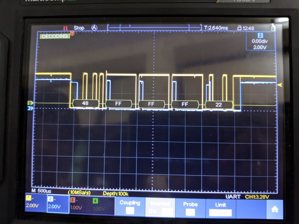

I am using STPM32 with UART communication. I am able to read all Default values as per datasheet. How to make the IC to start acquiring voltage current and update the respective registers.

    Below is the Arduino Mega code
    int receivedByte = 0;
    void setup()
     Serial.begin(9600); //MEGA TO PC
     Serial1.begin(9600); //MEGA TO STPM32
     delay(10);
    void loop()
     Serial1.write(0x48); // register for voltage and current read address
     Serial1.write(0xFF); // no write ADDRESS so (0xFF)
     Serial1.write(0xFF); // WRITE DATA
     Serial1.write(0x22); //crc value after calcultion
     Serial.println("data sent: (48 FF FF FF 22) "); //Print in PC
     Serial.println();
     Serial.print("I received: ");
     while (Serial1.available() > 0)
      receivedByte = Serial1.read();
      Serial.print(receivedByte, HEX); //here I'm receiving default value of all register
     Serial.println();
     Serial.println();
     delay(1000);

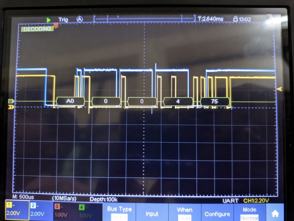

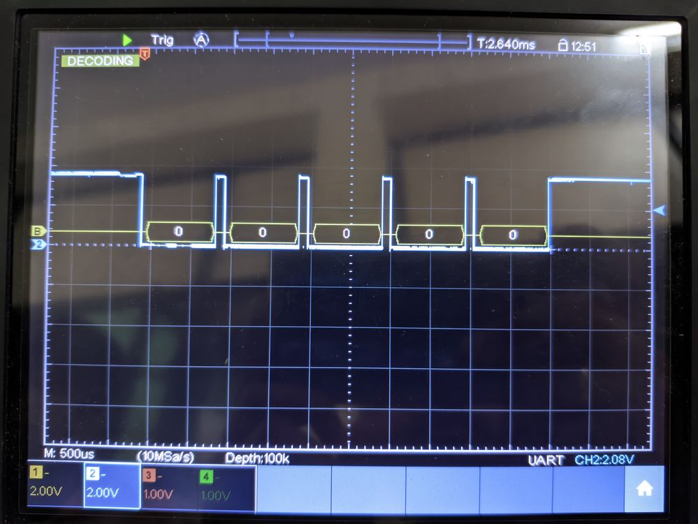

    Data recived for 48FFFFFF is 000000
    Register for voltage and current
    Data recieved for 0FFFFFF is A000475
    //Register address 0x00 as per data sheet default value is 040000A0 (just the reverse of what i recived)
    0693W00000JMdlkQAD.jpg48FFFFFF22 Transmit Data
    0693W00000JMdm9QAD.jpgRevieve Data for 48FFFFFF22

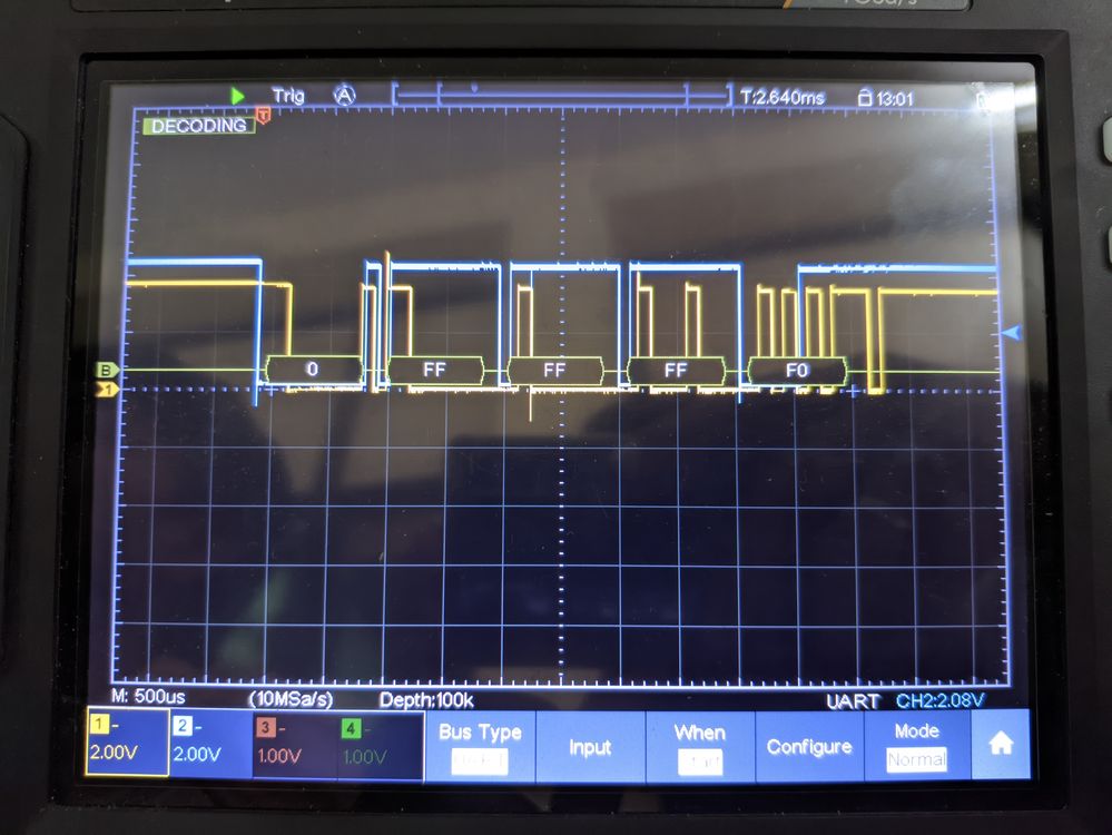

    0693W00000JMdmdQAD.jpg00FFFFFFF0 Transmit Data
    0693W00000JMdmiQAD.jpgRecieve data for 00FFFFFFF0

    Didier HERROUIN
    February 21, 2022
    No, you do not need to send any init command to get the chipset ready.
    Nevertheless, you need to enable the "Data latch" to get the values latched in the data register (see register dsp_cr3):
    • either by enabling the automatic SW latch (bit 23): the data will be latched every 128µs
    • or by enabling the "manual" SW latches (bit 20 & 21) each time you want to read some data: the data will be latched until the moment you will read the register
    Another option is to use the "manual" HW latch (pulse on signal SYN, see DS).
    The content of the register 0 you received is correct (0xA0 00 00 04, as frame format is LSBfirst).
