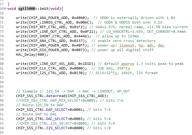

    I have this function and I would like to call from my Main.
    0693W00000SvMVbQAN.pngThank you for your helps

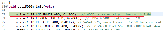

    Now I declared a variable of class SGTL500
    0693W00000SvMzMQAV.pngAnd when I want to initialize with the method (void sgtl5000 :: init(void))
    I call it that way
    audio.init();

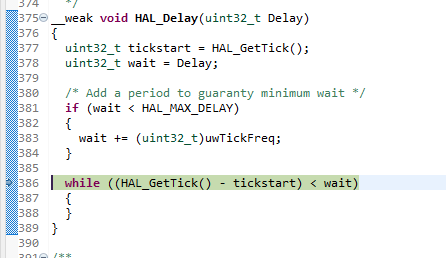

    But after I'm stuck at this feature :
    0693W00000SvN1rQAF.pngI feel like I'm stuck at this function but I don't know what it's for. Do you have any idea where my problem comes from ?
    0693W00000SvN2QQAV.pngThank you for your helps.
