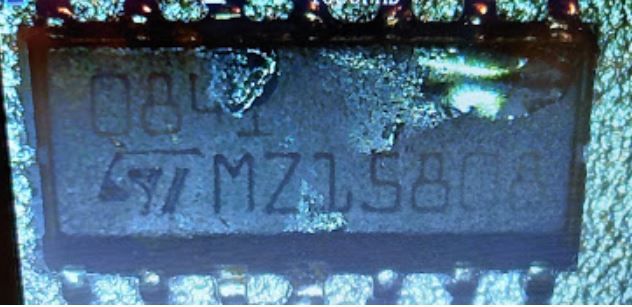

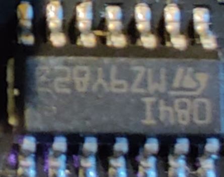

Hi, trying to decode the date code on some TL084IDT SO14. Can not find anything in the data sheets or other product documentation.
The two codes are: MZ15808 and MZ9Y823.
Solved! Go to Solution.
2020-09-18 2:56 AM
the device with DC MZ15808 was assembled in wk08 2018 and second part with DC MZ9Y823 was assembled in wk23 2018.
