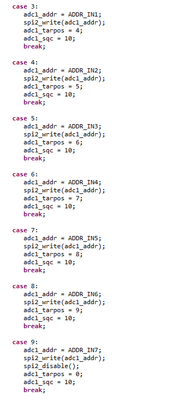

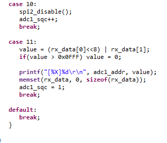

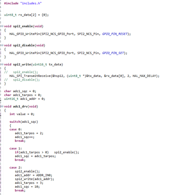

I'm currently testing a 2-axis joystick connected to an ADC120.
I want the X and Y axis values ​​to go into IN0 and IN1, but only the X axis values ​​go into all channels. The channel changes normally, but is it possible to separately input 2-axis data into IN0 and IN1? ?
I can show you my code if you need it.
thank you

The stm32 i am currently working on is stm32f407.
This code sends data through ADC120 via SPI communication.
Please let me know if you need further information.
