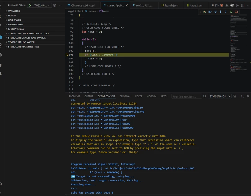

5. Build the project
Now that all steps are configured, it is time to build the application,press Ctrl+Shift+P and then type/click [CMake: Clean Rebuild] for a clean and rebuild action.
You should see something similar to the following in the Build Analyzer (lower left corner) and Build Output window:
6. Create and modify the launch.json file
  • Open the Run and Debug view (Ctrl+Shift+D).
  • Click create a launch.json file.
The current recommended pipeline is to use the STM32CubeIDE extension for STM32N6 XIP debug sessions.
Edit the generated launch.json to support debugging with all features enabled.

6.1 Explanation of the launch.json file changes
type: stlinkgdbtarget
This selects ST-LINK GDB target as the debug adapter.
It means VS Code will use the debugger integration rather than a generic GDB configuration, which is important for STM32-specific features such as board support, flash access, and the ST-LINK debug workflow.
request: launch
This starts a new debug session on the target rather than attaching to an already running program.
In this workflow, the debugger is responsible for launching the session from the FSBL and preparing the target for XIP debugging.
name: "STM32N6570-DK / ST-Link Debug"
This is the label shown in the VS Code debug configuration list. The name clearly identifies both:
  • the board: STM32N6570-DK
  • the debug interface: ST-Link This makes the profile easy to recognize when multiple configurations exist.
cwd: ${workspaceFolder}
This sets the current working directory for the debug session to the root of the opened workspace. Any relative paths used by the launch configuration are resolved from this folder, which keeps the setup portable across machines.
preBuild: ${command:st-stm32-ide-debug-launch.build}
This tells VS Code to run the build command before starting the debug session. It ensures the binaries are up to date and that the ELF files required by the debugger are generated before launch.
deviceCore: "Cortex-M55"
This specifies the CPU core of the target device. The STM32N6570-DK uses a Cortex-M55, so this setting allows the debugger to initialize the correct core context and use the appropriate low-level debug behavior.
imagesAndSymbols
This section lists the ELF files used by the session. It combines the FSBL and the Application image and symbols in one configuration.
  • STM32N6_XIP_Appli.elf This is the application ELF stored in external flash.
    It is used so the debugger can resolve application symbols and provide source-level debugging once execution reaches the XIP code.
  • STM32N6_XIP_FSBL.elf This is the FSBL ELF, which acts as the first executable after reset. The FSBL initializes the external memory interface and enables memory-mapped mode, so debugging must start from it.
The presence of both ELFs allows the session to start from the FSBL and still display symbols for the XIP application later. However, these ELF files are used only for the debug session; the trusted binaries must still be flashed separately because they are the persistent images required by the boot flow.
serverExtLoader
This section defines the external flash loader used by the ST-LINK GDB server.
  • loader
"loader": "C:/Program Files/STMicroelectronics/STM32Cube/STM32CubeProgrammer/bin/ExternalLoader/MX66UW1G45G_STM32N6570-DK.stldr"
This points to the .stldr file required to access the external serial flash on the STM32N6570-DK. The debugger needs this loader to correctly read, program, and interact with the XIP storage device.
  • initialize: false
This means the external loader is provided to the debug server, but it is not explicitly initialized in a separate step from this configuration. In practice, the loader is available so the debug infrastructure can use it when needed to access external flash.

Hello ST team,
I am debugging an STM32N6 FSBL + Appli XIP project in VSCode using ST-LINK GDB Server.
The Appli image runs from external Flash around 0x70100000.
GDB can attach and stop inside the application correctly:
0x70100eac in main() at Appli/Src/main.c:103
However, when I press Pause/Interrupt in VSCode, the CPU stops only briefly.
After about 10 seconds, the target stops responding and the debug session is disconnected:
Program received signal SIGINT, Interrupt.
Target is not responding, retrying...
GdbSession, Lost target connection, Exiting...
Remote communication error. Target disconnected.
So the issue is not only symbol loading.
The application can be stopped at main(), but the debugger cannot keep the target halted for more than a few seconds.
Could you please advise what may cause the target connection to be lost while the STM32N6 is halted in debug mode?
Questions:
  1. Is there any watchdog, security, low-power, or external Flash/XIP-related setting that can cause the target to disconnect while halted?
  2. Is any special debug configuration required for STM32N6 FSBL + Appli XIP debugging in VSCode?
  3. Should any STM32N6 debug freeze register or option byte be configured?
  4. Is this a known issue or limitation with ST-LINK GDB Server and STM32N6 XIP debugging?
Environment:
  • MCU: STM32N6 series
  • Debug probe: ST-LINK
  • ST-LINK GDB Server: 7.13.0
  • GDB: GNU Tools for STM32 14.3 / GDB 15.2
  • IDE: VSCode
  • Interface: SWD
Jun 12, 2026 6:41 AM UTC
Hello ST team,
I would like to share an update.
During debugging, I found that the following memory read errors were occurring:
[3.298] handlePacket(): Reading 0x20 bytes of memory from addr 0x341ffff0
[3.299] read(): Rx: $m341ffff0,1#2a
[3.299] handlePacket(): Reading 0x1 bytes of memory from addr 0x341ffff0
[3.299] read(): Rx: $m3420000f,1#89
[3.299] handlePacket(): Reading 0x1 bytes of memory from addr 0x3420000f
It looks like GDB or the debugger was trying to read memory near the end of the RAM region, and this caused the debug session to become unstable or disconnect.
I modified the _estack definition in both linker script files:
  • STM32N657XX_XIP.ld
  • STM32N657XX_AXISRAM_2fsbl.ld
Before, _estack was located exactly at the end of the RAM region.
After changing it as follows, debugging worked normally:
_estack = ORIGIN(RAM) + LENGTH(RAM) - 0x100;
With this change, the debugger no longer disconnects when the target is halted, and pause/step/breakpoint debugging works correctly.
Could you please confirm whether this is the recommended workaround or if the default linker script should reserve some margin below the RAM end address for debug access?
Thank you.
