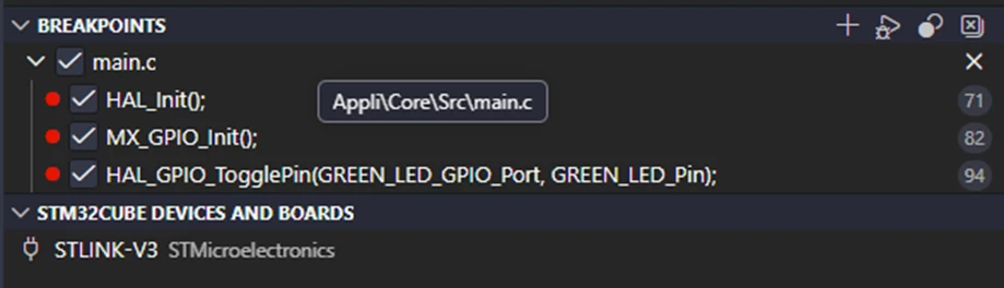

1. Breakpoint behavior in external memory
In an STM32N6570-DK XIP project, the application is stored in external serial NOR flash. The application becomes safe to execute only after the FSBL configures the external memory interface in memory-mapped mode. Although the debugger can already know the application executable and linking format (ELF) file and its symbols, the application region is not ready for standard breakpoint handling when the session starts.
This condition makes breakpoints in external memory a special case. In a standard debug flow, previously stored breakpoints are often restored as soon as the debugger connects. For applications that run from internal flash, that behavior usually works without issue. In an STM32N6 XIP configuration, however, restoring application breakpoints too early can make the debug session fail. This is because the debugger tries to activate breakpoints in a region that the FSBL has not yet prepared.
This behavior is usually observed as follows:
- The debug session fails at startup.
- The failure often occurs if application breakpoints remain from a previous session.
- Removing those breakpoints usually allows the session to start normally again.
- After execution reaches BOOT_Application, breakpoints in the application can be used normally.
The root cause is not symbol visibility, but the timing of breakpoint activation relative to the STM32N6 boot sequence. At startup, the FSBL is the only valid debug context. The application symbols can already be available on the host side, but application breakpoints must become active only after the external flash is configured in memory-mapped mode.

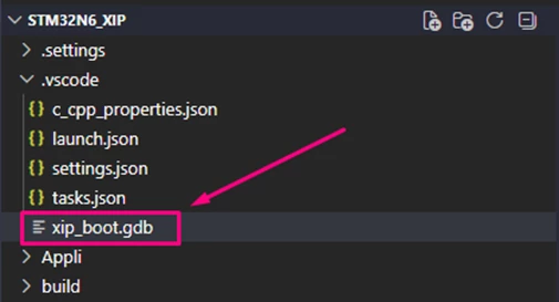

3. Create the GDB script
The next step is to create the GDB script used by “preRunCommands”. This script is the key element of the breakpoint-management method, because it changes when the application breakpoints become active.
Create the following file in your workspace:
Then add the following content:

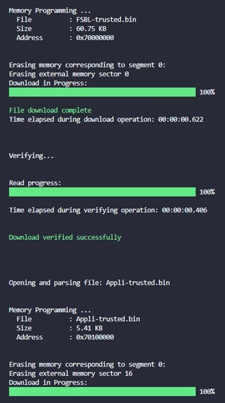

4. Use the existing flashing task
The trusted binaries must still be programmed into external flash before the debug session starts. Since this article assumes that the base STM32N6 XIP workflow is already working, there is no need to create a new flashing method here. The same task used in the reference debug article can continue to be used.
In the configuration shown previously, this is done through:
"preLaunchTask": "Flash STM32N6 (DEVBOOT)"
This means that before the debugger starts, VS Code runs the task that flashes the following files into external flash at their expected addresses:
FSBL-trusted.bin
Appli-trusted.bin
This step remains important even though the debug session later performs a temporary download of the FSBL ELF. The temporary -target-download command exists only for the active debug session, while the trusted binaries are the persistent bootable images that the STM32N6 boot flow requires.

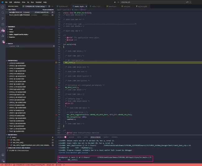

5. Debug workflow
Once the launch.json configuration has been updated and the GDB script is in place, the debug session can be started normally from VS Code.
At the beginning of the session, the trusted binaries are flashed through the existing prelaunch task, and the FSBL ELF is downloaded temporarily for the active debug session.
After that, the GDB script takes control of the early boot phase. The script first disables the user breakpoints that were already present before entering debug mode. It then places a temporary breakpoint at BOOT_Application and lets the FSBL continue running. When execution reaches that point, the external flash has already been configured in memory-mapped mode, so the script can safely re-enable the user breakpoints.
From the user point of view, the workflow is simple:
- Start the debug session as usual
- Let the FSBL execute until the temporary stop at BOOT_Application
- Continue debugging normally from that point onward
A practical advantage of this method is that you can keep your breakpoints in the external-memory application between sessions. They do not need to be removed manually before starting the debugger, because the GDB script temporarily disables them during the early boot phase and restores them only after the system reaches a safe point.
