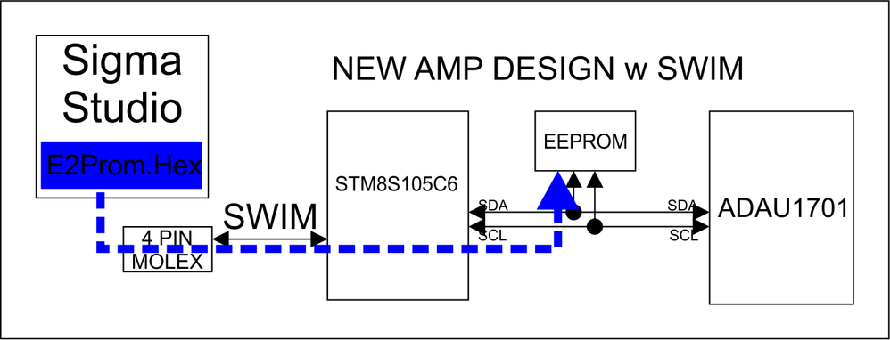

A couple of graphics that may help some.
Here is the old design. It had an 8pin header that I was able to use an adapter to connect to and it allowed SigmaStudio to work directly with the ADAD and also allowed writing to the e2prom to enable self-boot. SigmaStudio generates the e2prom.hex file that is stored in the 24c64wp.

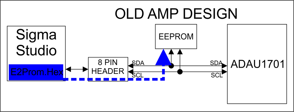

Here is the new design:
They are using an STM8 to generate the hex file that the e2prom requires for the ADAU to self-boot.
The blue indicates what I need to accomplish... use SWIM to open up the I2C ports of the STM8 to transfer the E2Prom.hex file to the 24c64wp.
Hopefully this makes sense given my lack of proper terminology.

Is there another program between Sigma Studio and SWIM connector? As I know Sigma Studio can connect with other boards by USBi not  ST-LINK and SWIM interface.
MFarl
There is a program between that is being used on the STM8 if I am understanding you correctly. You are correct in that SigmaStudio can't connect via SWIM at all but I have another amp I can use with Sigma to generate the hex file I need to send to the 24c64wp.
I put SigmaStudio in the graphic just to show that I'd be using it to create the hex file. Hopefully that wasn't too confusing.
What I am not sure of is if trying to use a utility to write to the 24c64wp via I2C will erase the existing program used by the STM8. If it does that is OK by me but if it doesn't that would be a nice bonus.
I know using SigmaStudio directly via I2c I can run a program for testing and changing parameters and as long as I don't write it there'll be no impact to the existing program. Hopefully that kind of thing can happen with the STM8.
Thanks!

Karol Merski
I understand it like that (image is in attachment)
MFarl
Yes, you are correct with regard to the architecture but there are no accessible pins for I2C to the EEPROM so I'll have to find a way to go through the STM8 using SWIM as those are the only pins I have access to.
