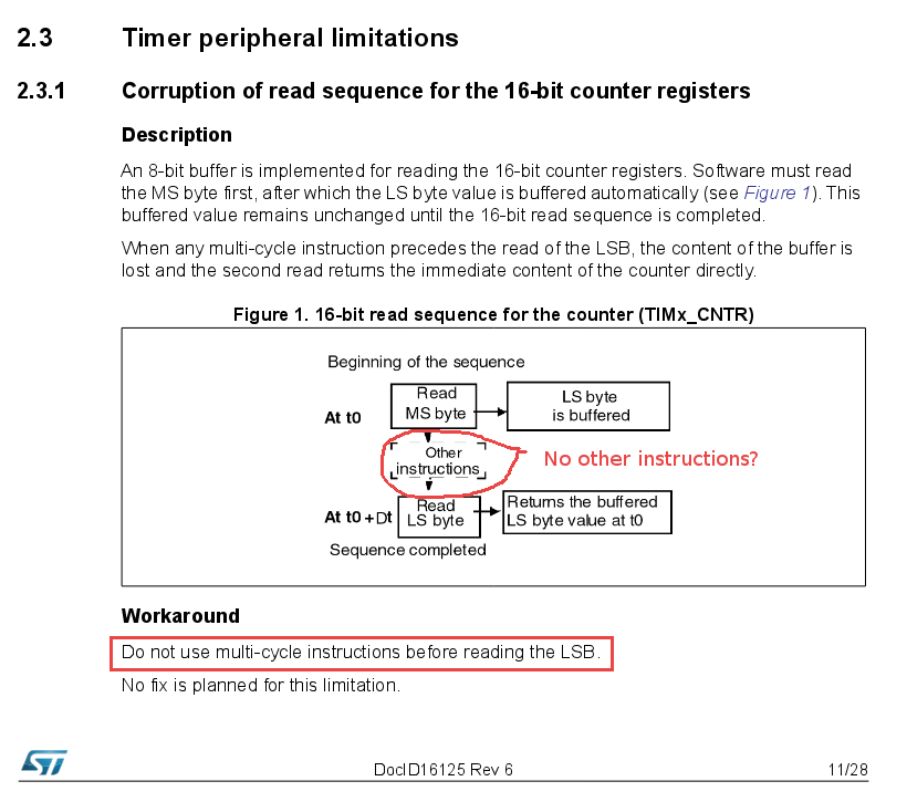

So, info in reference manual is irrelevant? The read should be always done as:
; Read Seq_1
ld A, TIM1_REGH;
ld XL, TIM1_REGL;�?�?�?
Will the following sequences lead to incorrect results?
; Read Seq_2
ldw X, #TIM1_REGH; Store in X address of TIM1_REGH
ld A,(X); Read TIM1_REGH
push A;
incw X; Set pointer to TIM1_REGL
ld A,(X); Read TIM1_REGH�?�?�?�?�?�?
; Read Seq_3
push A;
ldw X, #TIM1_REGL; Store in X address of TIM1_REGL
ld A,(X); Read TIM1_REGL�?�?�?�?�?�?�?�?

Posted on January 19, 2017 at 10:42

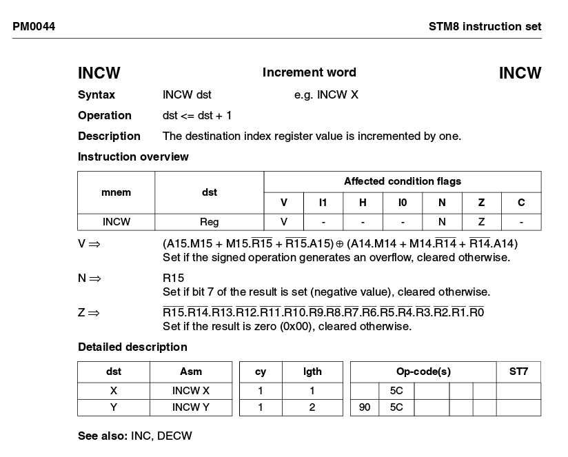

In the three code snippets you are referring too, the only multiple cycle instruction is the INCW X you have in the Read seq_2
As a consequence Read seq_1 and Read seq_3 are OK, but you should not use Read seq_2 for 16-bit TIMer access.
This also means that the recommendation in the RM is correct.
If you want to check if an instruction execute in multiple cycles, please refer to
http://www.st.com/content/ccc/resource/technical/document/programming_manual/43/24/13/9a/89/df/45/ed/CD00161709.pdf/files/CD00161709.pdf/jcr:content/translations/en.CD00161709.pdf
The Table 42 page 64 to 74 has a column showing the number of cycles.
Let me know if this is still not clear

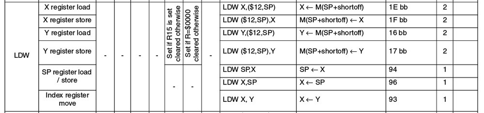

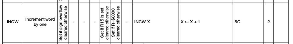

Posted on January 19, 2017 at 11:24
This is from doc linked by you:0690X000006065QQAQ.png0690X00000605yfQAA.png
1 cycle or 2? Where the truth?

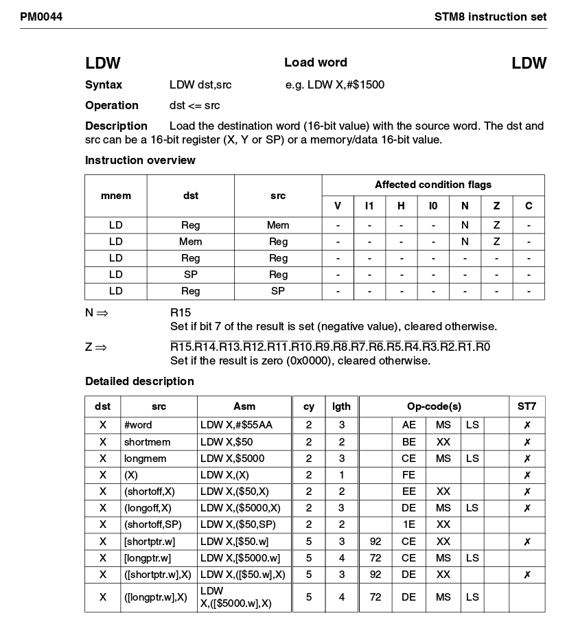

And for Seq_3: ldw is 2 cycle instruction. It's used to load TIM1->CNTRL to index register.0690X000006065RQAQ.png0690X000006065VQAQ.png
in Seq_1 I've made mistake. LD could not load from memory to XL.
So, none of this three reads will assemble or return correct result.
