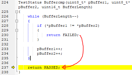

I am testing the STM8 SPL with the STVD IDE and Cosmic compiler. The target is a NUCLEO-8S208RB board. During simulation of the SPL example 'UART_interrupt' the function Buffercmp() in the below screenshot behaved as follows.
Observation: the statement in line 230,
return FAILED;
does not exit the function. Instead, it jumps to the next return statement in line 237,
return PASSED;
As a result the comparison passed, regardless of the comparison outcome. This behavior is not consistent, and it seems to be a simulator issue.
Question: Is this a known issue? The returned TestStatus type is an enum variable, could that be an issue? Thank you!
