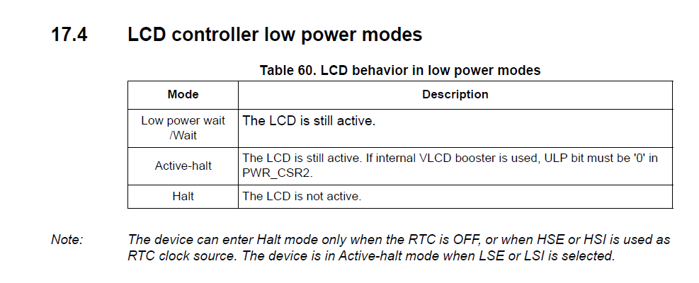

mcu into active-halt mode, so i can not enable ULP?
if i set ulp to 1, then the lcd blinks
